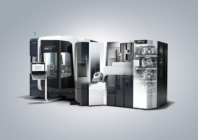

"For our customers today and in the future, it is all about creating quality-oriented, competitive and sustainable production. With decades of experience in industries such as Aviation & Space, Die & Mold, Semiconductor as well as in classic Mechanical Engineering, DMG MORI offers solutions based on the Machining Transformation (MX) model," says Cornelius Nöß, Managing Director of DMG MORI Pfronten GmbH. Process integration increases efficiency by bundling machining steps such as milling, turning and grinding. Examples of this are the DMC 125 FDS duoBLOCK shown at the Open House in Pfronten and the CTX gamma 2000 TC. Automation creates continuous machine availability and therefore higher production capacities, as the Robo2Go Max demonstrates live on the CTX gamma 2000 TC. Digital Transformation (DX) supports technology cycles with the CELOS X widgets for more efficient planning and simulation of production processes. Together, these pillars and additional measures, such as the adaptive coolant supply, promote the Green Transformation (GX), i.e. more sustainable production with reduced energy consumption. DMG MORI is presenting the complete PH Cell series for pallet handling from 300 to 2,000 kg transfer weight as well as the PH Cell Twin for linking two machines for 24/7 production and increasing spindle running times. The new e-PALLET system revolutionizes the classic machine table, enables the use of smart clamping devices and uses intelligent software. It also increases flexibility and optimizes processes. The intuitive operation is complemented by the Clamping Master.

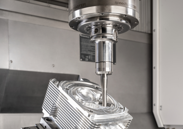

With the DMU 60 eVo 2. Generation, DMG MORI is setting new standards in 5-axis universal machining and a milestone for precision and productivity. Based on the unique table kinematics, the proven machine concept has been fundamentally further developed to meet the increasing demands for precision, dynamics and flexibility. This is why the DMU 60 eVo 2. Generation successfully utilizes DMG MORI's Machining Transformation (MX) concept: The machine integrates manufacturing processes such as mill-turn machining, gear hobbing using the gearSKIVING technology cycle and grinding. This process integration transforms the DMU 60 eVo 2. Generation into a multifunctional machining solution that can be flexibly adapted to a wide range of requirements and industries and exploits the full potential of future-oriented machining technology. Intelligent automation solutions optimize machine utilization around the clock if required. Modern control options - a SINUMERIK One and a HEIDENHAIN TNC 7 - on CELOS X pave the way for Digital Transformation (DX).
