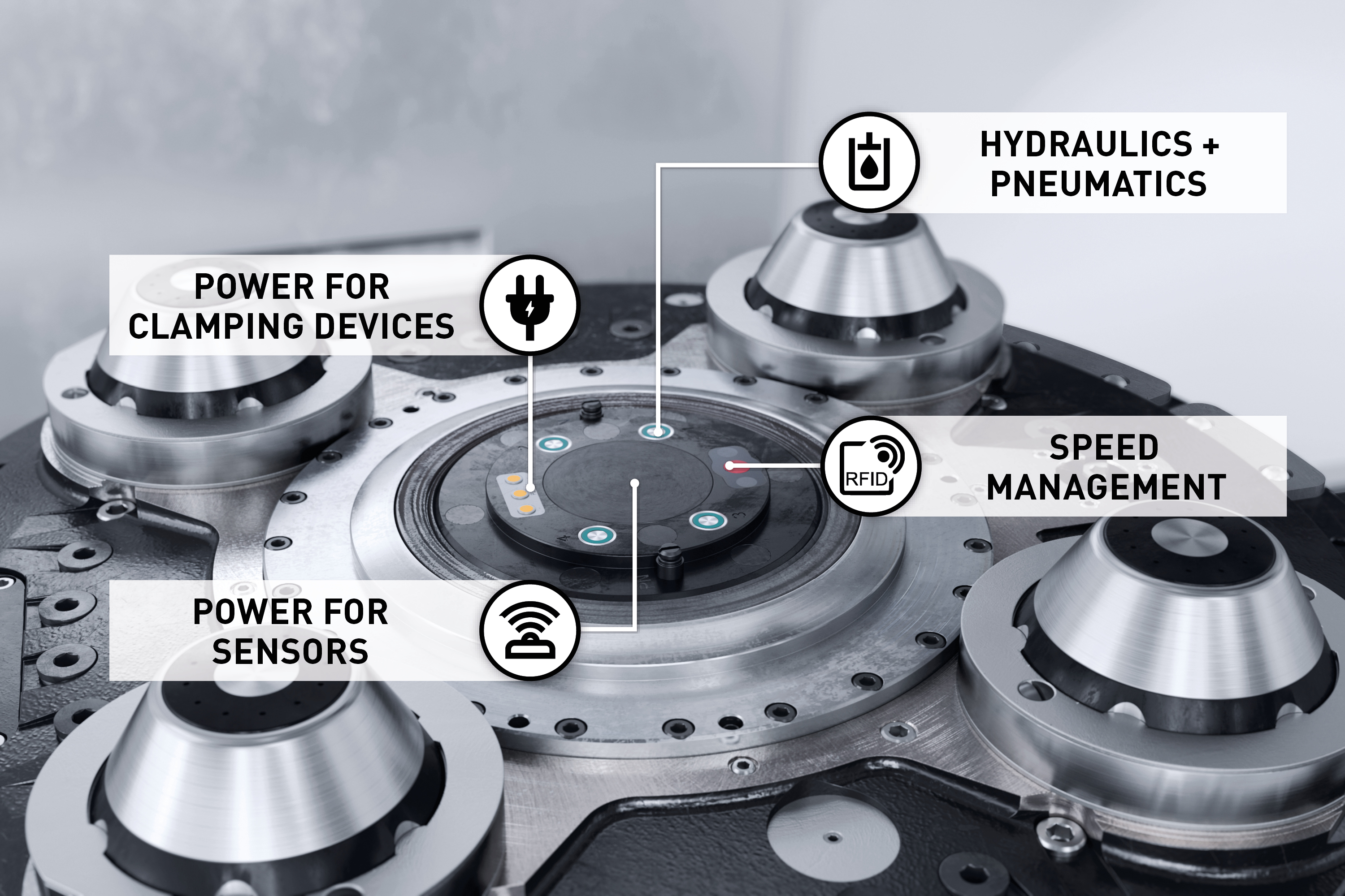

The E-Pallet has a smart interface for controlling electrical and hydraulic devices.
Hydraulic workpiece clamping offers numerous advantages, high clamping forces with simultaneous automation of clamping processes. In addition to these advantages, however, there are also challenges: higher energy costs, additional floor space of aggregates and a high variance of rotary unions. Their number of channels is limited, which limits the possibilities for process monitoring. DMG MORI has found a suitable answer with the E-Pallet, a smart interface for controlling electrical and hydraulic devices.
The E-Pallet interface can provide power for all-electric clamping devices with 48 V and 50 A via docking. It provides current for sensor technology (24 V / 4 A), which is transmitted inductively. This allows permanent interrogation of sensors.
In addition to power, the new interface can transfer up to four channels with hydraulics or pneumatics as usual. By using electrical directional control valves on the clamping device, these channels can be intelligently expanded, which removes the channel limitation. Another innovation at E- Pallet is safe speed management using RFID technology. This enables individual speed limitations of pallets and thus mixed operation of milling and turning applications on the same machine.

The built-in sensor system of the E- Pallet provides permanent digital monitoring of the tension at the setup station and in the working area of the machine.
Compared to conventional hydraulic clamping, the E-Pallet offers numerous advantages in application. In addition to process optimization, a new level of complexity can be mapped that meets the high safety requirements. The installed sensor system provides permanent digital monitoring of the tension at the setup station and in the machine's work area. High-precision monitoring of the support and presence, as well as path and force monitoring, can be implemented on the fixture side. Reinhard Musch, Managing Director of DECKEL MAHO Pfronten, is certain: “With its increased flexibility and the possibilities of digital monitoring, the maintenance-free E-pallet makes a decisive contribution to process optimization in metal-cutting production - and thus also to cost reduction.”
